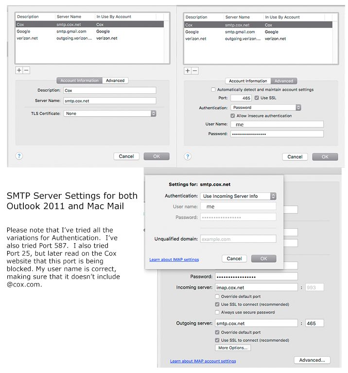

    I've been busy doing research.  I converted both my POP accounts to IMAP, which didn't help.  I also set up a Gmail account as a backup, and am able to both send and receive e-mails using this client.  Unfortunately, I am still unable to send e-mails from either Mac Mail or Outlook 2011 on my Mac Mini.  Here's a copy of my smtp.cox.net activity log from today:
    INITIATING CONNECTION Jun 21 11:18:15.511 host:smtp.cox.net -- port:465 -- socket:0x0 -- thread:0x7f8d13a89cc0

    Perhaps this info will be helpful.  I've also attached a photo that displays my current SMTP settings for both of my mail clients.  I'm pretty sure I've set everything correctly.  Really hope you can figure this out; it's been three weeks now of not being able to send mail using either of my desktop e-mail clients.  Fortunately I can send mail using Cox's webmail, and now also using Gmail, but I much prefer to be able to use my desktop e-mail clients.
    Thanks, David
    P.S. Sorry for the blurred image; I think it's clear enough to make out the settings I've set.

    Yes, that is correct.  I just didn't want to disclose my username in a public forum.
