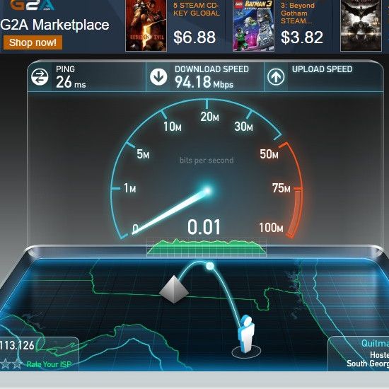

    This is getting ridiculous. Despite being told by the tech that everything was fixed for the second time and once again receiving a good signal for about an hour after the tech had departed, upload speeds are at an all time low. In fact, a speed test will not even finish, as I have been trying to finish one for the past hour with no luck. All readings freeze at .01 upload. the best I can provide is this local screen shot that I then had to edit the size of with a photo editor to even get it at a size that I can place on the forum.
    It took me an hour (It is now 3:22 AM) to even get these results to you in the manner provided. I am beyond frustrated at this point.
